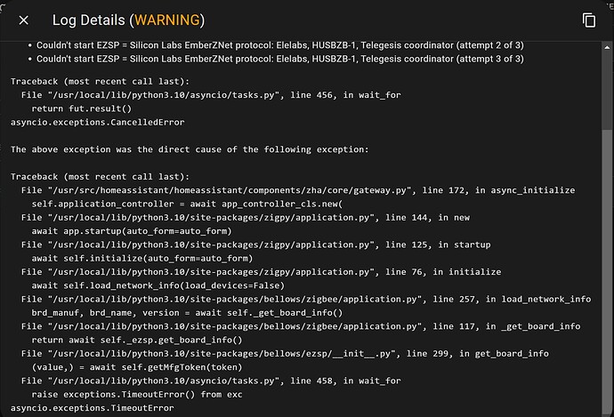

here are log from ZHA
Logger: homeassistant.components.zha.core.gateway
Source: components/zha/core/gateway.py:172
Integration: Zigbee Home Automation (documentation, issues)
First occurred: 2:22:42 PM (12 occurrences)
Last logged: 2:42:37 PM
Couldn’t start EZSP = Silicon Labs EmberZNet protocol: Elelabs, HUSBZB-1, Telegesis coordinator (attempt 1 of 3)
Couldn’t start EZSP = Silicon Labs EmberZNet protocol: Elelabs, HUSBZB-1, Telegesis coordinator (attempt 2 of 3)
Couldn’t start EZSP = Silicon Labs EmberZNet protocol: Elelabs, HUSBZB-1, Telegesis coordinator (attempt 3 of 3)
File “/usr/local/lib/python3.10/asyncio/tasks.py”, line 456, in wait_for
return fut.result()
asyncio.exceptions.CancelledError
The above exception was the direct cause of the following exception:
File “/usr/src/homeassistant/homeassistant/components/zha/core/gateway.py”, line 172, in async_initialize
self.application_controller = await app_controller_cls.new(
File “/usr/local/lib/python3.10/site-packages/zigpy/application.py”, line 144, in new
await app.startup(auto_form=auto_form)
File “/usr/local/lib/python3.10/site-packages/zigpy/application.py”, line 124, in startup
await self.connect()
File “/usr/local/lib/python3.10/site-packages/bellows/zigbee/application.py”, line 124, in connect
self._ezsp = await bellows.ezsp.EZSP.initialize(self.config)
File “/usr/local/lib/python3.10/site-packages/bellows/ezsp/init.py”, line 106, in initialize
await ezsp._startup_reset()
File “/usr/local/lib/python3.10/site-packages/bellows/ezsp/init.py”, line 97, in _startup_reset
await self.reset()
File “/usr/local/lib/python3.10/site-packages/bellows/ezsp/init.py”, line 126, in reset
await self._gw.reset()
File “/usr/local/lib/python3.10/site-packages/bellows/uart.py”, line 244, in reset
return await asyncio.wait_for(self._reset_future, timeout=RESET_TIMEOUT)
File “/usr/local/lib/python3.10/asyncio/tasks.py”, line 458, in wait_for
raise exceptions.TimeoutError() from exc
asyncio.exceptions.TimeoutError
Does your config still match the ports? I use the by-id port because it doesn’t change even if the OS assigns a different virtual port to the device, e.g:
port: >-
  /dev/serial/by-id/usb-ITead_Sonoff_Zigbee_3.0_USB_Dongle_Plus_82aeeb91e0c9eb119f658b4f1d69213e-if00-port0
if you go to the ZWave UI, does that addin still see the network? i recently have more ’ driver could not load’ or similar which seems the usb connection isnt restored. You running os 9.2 on hardware or on VM?

and do check the serial port config
Yes the serial port is wrong now I changed it back and Integration seems to work now
nice… both devices?
Yes both . It’s turn out that zwave use zigbee dongle port
Thanks a lot
