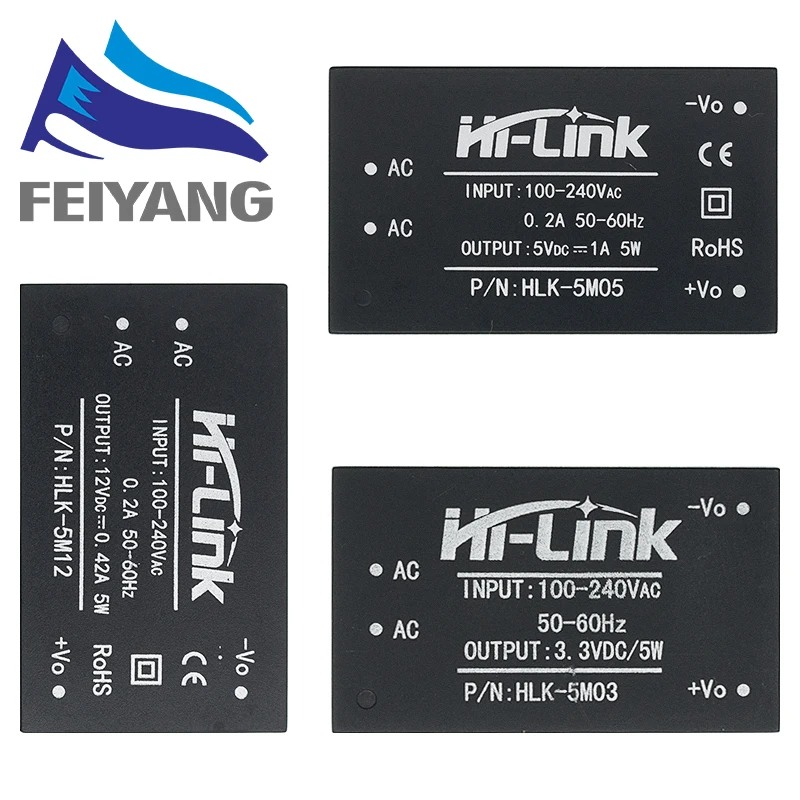

Maybe consider a small buck step-down converter like this:
You will need to check the spec’s to make sure it can deliver enough current for your tablet (this one appears good for up to 1A at 5V). A typical generic USB charger is usually good for something like 2.1A but bear in mind the smaller you go the lower the rated current.
