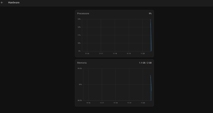

In fact, in the HARDWARE screen, I don’t see anything…
[image]
