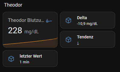

I am still using the notification interception within the HA Android App and it works just fine. I have some template sensors which show me the values of interest. Which are for me BG, trend, delta and age of the value. Not sure if google health will provide all of these.

Google health only provides the actual BG reading. I have a template sensor which keeps track of the value changes, giving me the ā€œage of valueā€ you have as well. Since trend and delta are just calculated from the BG readings, I’m sure you could create template sensors to generate those values based on the last however many readings you like. No reason to change your setup if it’s working for you of course.
This got me thinking. A delta sensor would only require the previous value and the current one, so that’s easy. For trend, it turns out that HA actually has a trend sensor for exactly this type of thing. I didn’t know that and I’ve never used it. I’m going to set one up and compare it with the xdrip trend readings. I’ll report back.

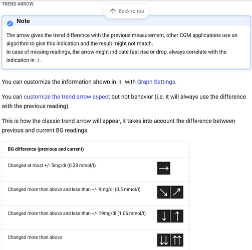

@Wilko The Xdrip trend is really simple, and only compares the last two readings. Screenshot of the xdrip docs attached. No ā€œtrendā€ sensor or derivative sensor needed in HA. I created a helper to hold the previous value and an automation to set current value to previous whenever a new value comes in. Then there’s a template sensor for the delta, and then another template sensor which translates the delta into the trend and adds arrows for visualization. Happy to provide code snippets if anyone is interested.
