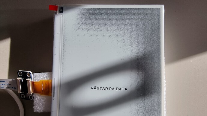

Just got my e-paper display and got it running… sorta…
But my display is fading from one side to the other … Any hints?

It seems when my device has been off for a while and starting it up again will make the fade go away but return.
One thing to try might be to make the display go completely white when not at home or night mode is on and see if that can help. Or maybe just smart plug it and cut the power but I would rather having the first option work.
Not sure how to implement it in code though.
I think that’s the way to go! I have added a deep sleep mode in the code and the screen stays pretty good. I will update the code on my site to the current version. I have used example 4 on this site: https://www.wirewd.com/make/blog/esphome_sleep_modes
That’s great news! Can you pinpoint what changes you did? I did go trough your code but not 100% how it works.

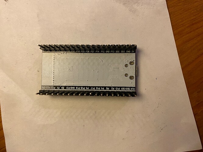

So I’m having some issues connecting to my esp32 (generic 38 pin esp-wroom-32, pins are labelled with P, white back-side) - seems like my pin connection is off and I need some help…I have the “Waveshare 7.5 Inch E-Paper Display HAT Module V2” version (I connected it to a raspberry pi and it worked) - any suggestion on how to troubleshoot and find/change pins? Some test code that will help? Pin-translation from GPIO to “P” :slight_smile:
My back-up is to use an 8266-unit instead, either LoLin NodeMCU v3, or a Wemos D1 Mini, since I understand the pinout better on those :slight_smile: can the code above be adapted for 8266 instead?

Progress! So it seems the 3,3 V on the board was not able to drive the screen - when I connected to 5 V it turned on. I did do some tests with ESP8266 as well, but it seems like they are not capable of driving the screen at all.
