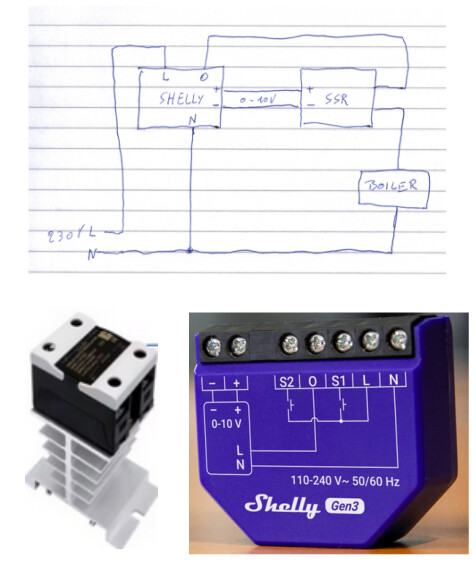

Easiest and safest DIY setup that comes to my mind would be Proportional SSR combined with Shelly 0-10V PM Gen3. Has been successfully done on this forum.

I made this dimmer with a shelly 0-10V dimmer, a 0-10V SSR I got from Ali-Express, and the HomeWizard P1 meter that reports the energy you consume or inject into the mains network.
If you already have Home Assistant, it is really cheap to build.
Carefull, you are working with real electricity, high currents, so your wiring must be good to avoid a fire.
