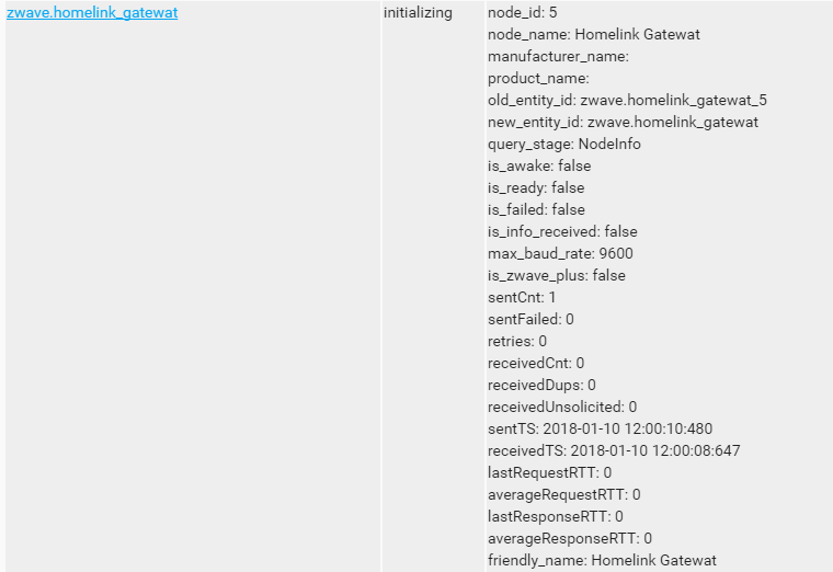

@tmjpugh I just received the Wayne dalton unit. It shows up in my node list but I am not seeing anything in the logs when i press a scene button.
Here is what is now in my zwcfg.xxx.xml file. I am not sure if it might need anything else like the homeseer switches.
<Node id="5" name="Homelink Gateway" location="" basic="1" generic="1" specific="0" type="Remote Controller" listening="false" frequentListening="false" beaming="false" routing="false" max_baud_rate="9600" version="3" query_stage="Probe">

I also checked the States page and saw that the state of the gateway is initializing. Im guessing that has something to do with it.
It looks like there isn’t a config in open-zwave for this device. You’ll need to find some docs about the the supported command classes.
Edit: Found this http://products.z-wavealliance.org/products/538/pics
Edit2: Also found this:
http://wiki.micasaverde.com/index.php/Wayne-Dalton_WDHA-12
Seems like it needs to be added as a second controller or something?
