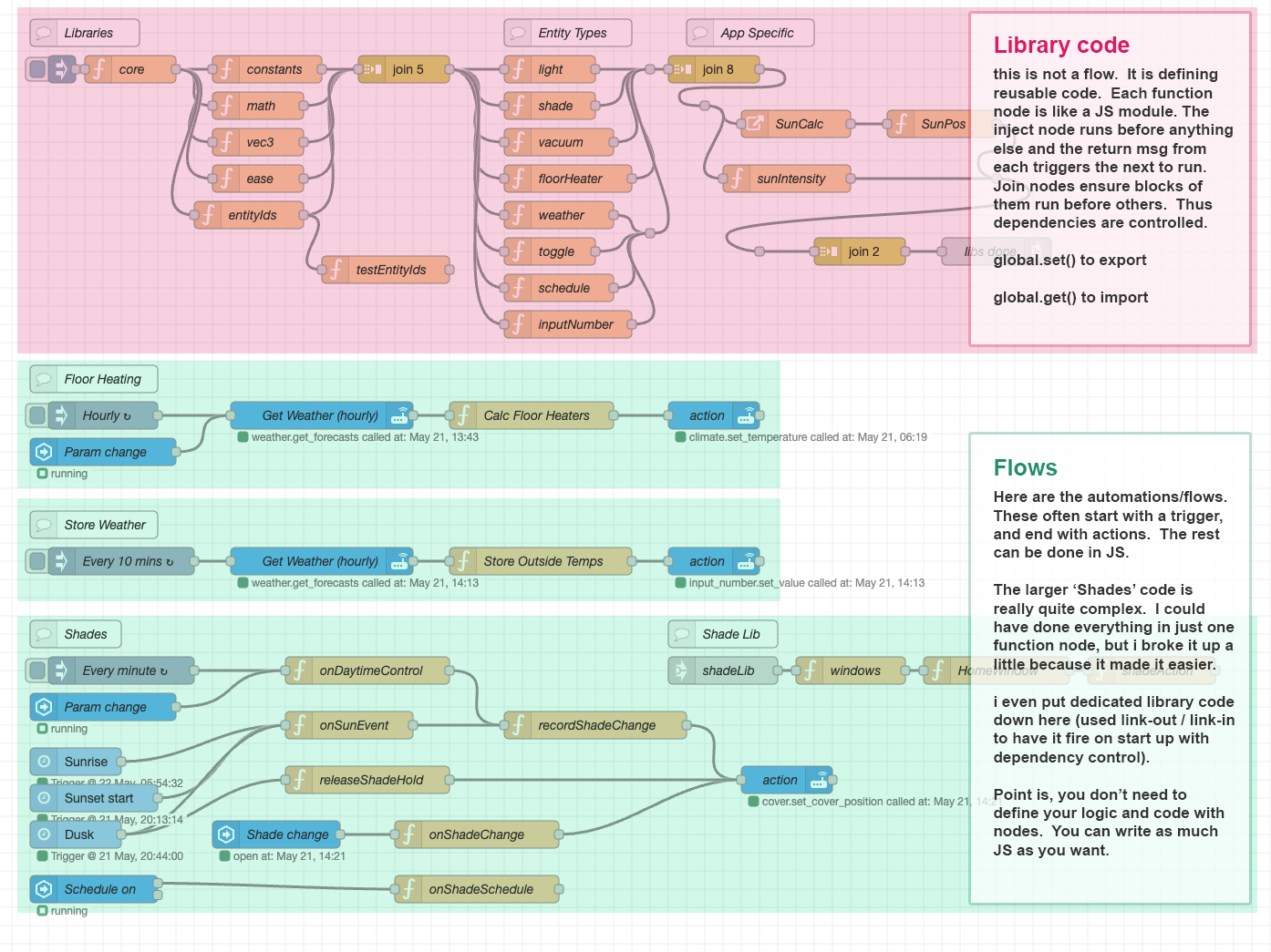

Emulate JS Modules (export and import):
  • use function nodes like JS modules. Define reusable code and use global.set() in place of export.
  • Likewise, use global.get() in place of import to pull code in.
So library code in a function node looks like this:
const { debug } = global.get('core');  // import a core routine
const lib = {
  add: (x, y) => {
    debug(`i'm adding ${x} and ${y}`);
    return x+y;
global.set('lib', lib);  // export
return msg;    // you need this
Get those dependencies to run in the right order
You need to ensure dependencies run first. Don’t use ā€˜Setup’, ā€˜on Start’ or ā€˜On Stop’ in the function node. Have all code defined in the standard ā€˜On Message’ tab. You just set up an inject node to inject once after ā€œ0.1 secondsā€ (not 0). and tie your dependences together. If your dependency tree gets a little complicated like mine, use join nodes (set mode to manual, and ā€˜after a number of msg parts’ set to number of nodes it is listening to). See below for the picture.
