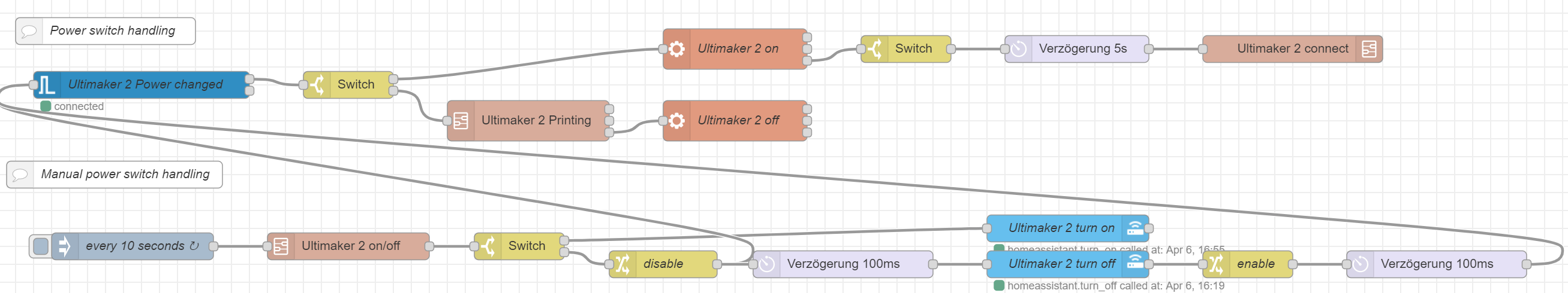

Here a shot of that flow:
The top turn my printer on and off when I use the input_boolean of HA, the lower checks if the printer is online in case I switch in on or off manually and then sets the input_boolean by calling the service, but that call triggers the upper flow…
Ah ok. I think I understand. When you turn on with the bottom flow, it is just to make sure that HA and your manual action are in sync. Correct ?
In this case, on the top flow, insert a trafic light between “trigger” and “switch”. By default make it green. So, When HA triggers it, it will be activated.
On the bottom flow, before calling the “turn_on” service, send a “red” message to the traffic light of the top flow. Then call turn_on. Wait a bit, eg 5 sec, and then send a “green” message to the trafic light. By doing so, HA will receive the “turn_on”, the trigger will be activated but the traffic light will do its magic, as it will be red, the message will not be sent to the rest of the flow.
