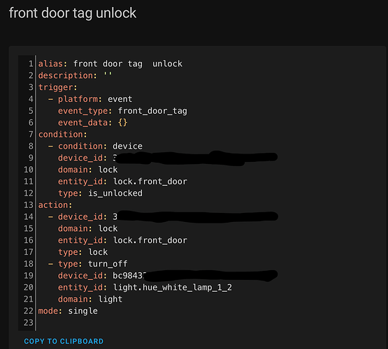

Here’s the automation in HA:

Well that’s what I thought too. No, there’s no device_id in the automation.
It just listens for the event front_door_tag to have {} in the event data. No additional identifiers.
This is the shortcut automation on the iPhone:
This is the automation in Home Assistant:
