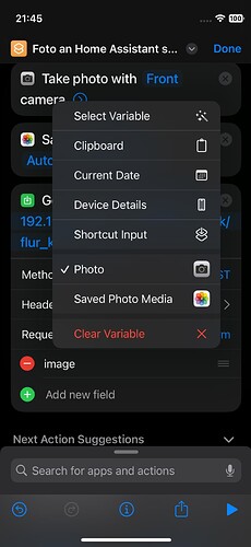

I have a wall mounted iPhone which shows my HA dashboard in Guided Access mode.
As a workaround for pushing the camera image to HA I currently use an iOS shortcut to take a row of photos and send them via web hook (see push camera platform) to my HA server. The advantage is, that the photos can be taken even though the HA app is still active.
camera:
  - platform: push
    webhook_id: flur_kamera
    buffer: 10
    timeout: 12
Saving the photo is not mandatory.
The photo file is passed to the image form parameter.
To trigger this shortcut I created an iOS automation, which responds to disconnection from power.
The charger is plugged into a smart plug and this smart plug is controlled via a HA automation, which responds to a motion sensor and turns the smart plug off for some seconds and then on again.
I found, that sometimes the iOS shortcut automation is not triggered correctly, but it should help to send some push notification (via HA) to the phone (see Introduction | Home Assistant Companion Docs) to wake it up just before the smart plug will be turned off.
It’s not the prettiest solution, but it works for the moment. Hope it helps some of you while we are waiting for real camera access in the HA app :wink:
