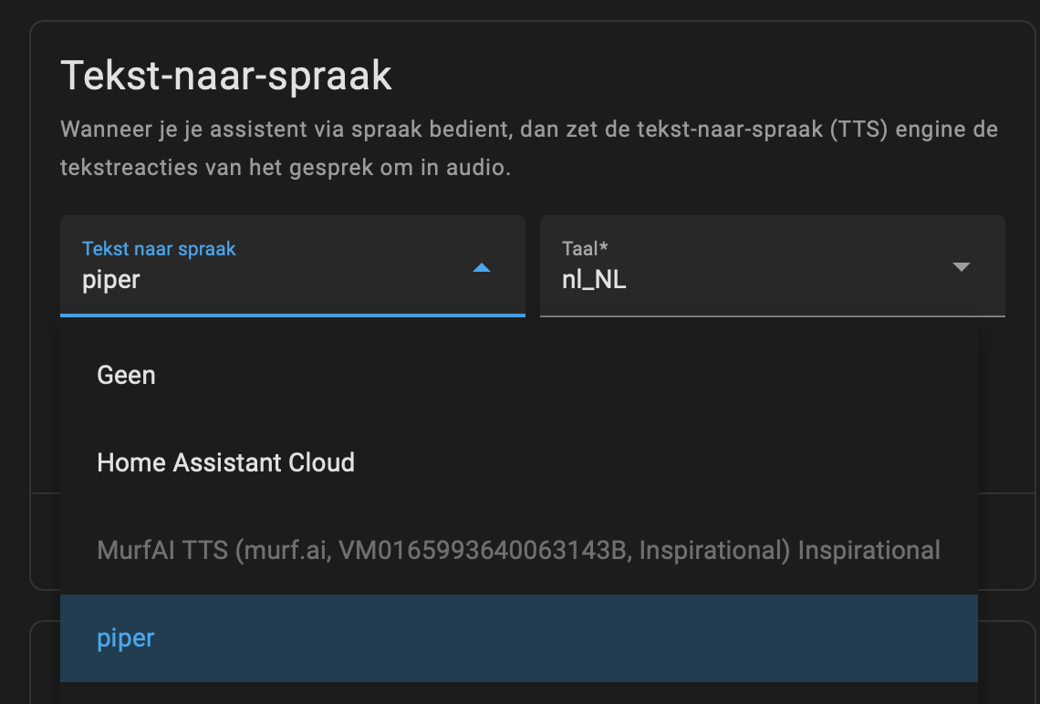

I have integrated this, but when i want to select it as my TTS service it is grayed out. Also i don’t see where i can paste my API key.
