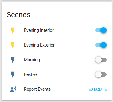

Maybe this will be useful. I needed a pushbutton that would trigger an announcement. I used a script mostly because it’s rendered in the Frontend UI with an “EXECUTE” quasi-pushbutton (“quasi” because it works like a pushbutton but doesn’t look like one).
The announcement is actually part of a scene in my Premise server. Home Assistant talks to Premise via an MQTT topic: premise/command/scenes/reportevents/play
In Premise, scenes can have one of two behaviors:
  • Set-Restore. This is an on/off switch and behaves like Home Assistant’s scenes.
  • Set. This is a momentary boolean (a trigger) and has no equivalent in Home Assistant.
The ‘Report Events’ scene is a ‘Set’ behavior (momentary boolean) so, with no counterpart in Home Assistant, it’s simulated with an MQTT Switch.
In switches.yaml:
  - platform: mqtt
    state_topic: "premise/scenes/reportevents/play"
    command_topic: "premise/command/scenes/reportevents/play"
    payload_on: "1"
    payload_off: "0"
    state_on: "1"
    state_off: "0"
    retain: false
I don’t want to see this switch in the UI because it’ll be rendered as a toggle button. So I use customize.yaml to hide it.
script.report_events:
  icon: mdi:voice
switch.report_events:
  hidden: true
To simulate momentary boolean functionality, I need to set the switch to true momentarily then return it to false. That’s easily done in a script which also happens to be rendered in the UI with that quasi-pushbutton I mentioned earlier.
In scripts.yaml:
  report_events:
    alias: Report Events
    sequence:
      - service: switch.turn_on
          entity_id: switch.report_events
      - service: switch.turn_off
The result is the last line in this Scenes card:
Scenes
The first four scenes are ‘Set-Restore’ behavior so they are easily modeled with switches. FWIW, the word “EXECUTE” is the default and cannot be modified unless you install Custom UI (which offers that ability and much more).
EDIT
The (hidden) MQTT Switch isn’t necessary to get the job done and was included to illustrate a point (simulating a pushbutton with an existing switch). Here’s a simplified version that only uses a script:
