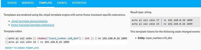

What does that output in the Template developer tool?
Thanks for that question, which made me discover what templates are for. :grinning_face_with_smiling_eyes:
The result in the template changes with the position of the slider and gives the correct output.
