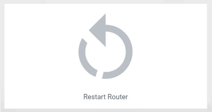

If you need the switch only in the UI then you can do something like this
entity: zone.home
hold_action:
  action: none
icon: 'mdi:restart'
show_icon: true
show_name: true
tap_action:
  action: call-service
  service: xxxxxxxxxxx
type: entity-button
the “zone.home” is only used as dummy (you can use any other entity)
MarH, frikkin brilliant, its exactly what I was looking for :smiley:
