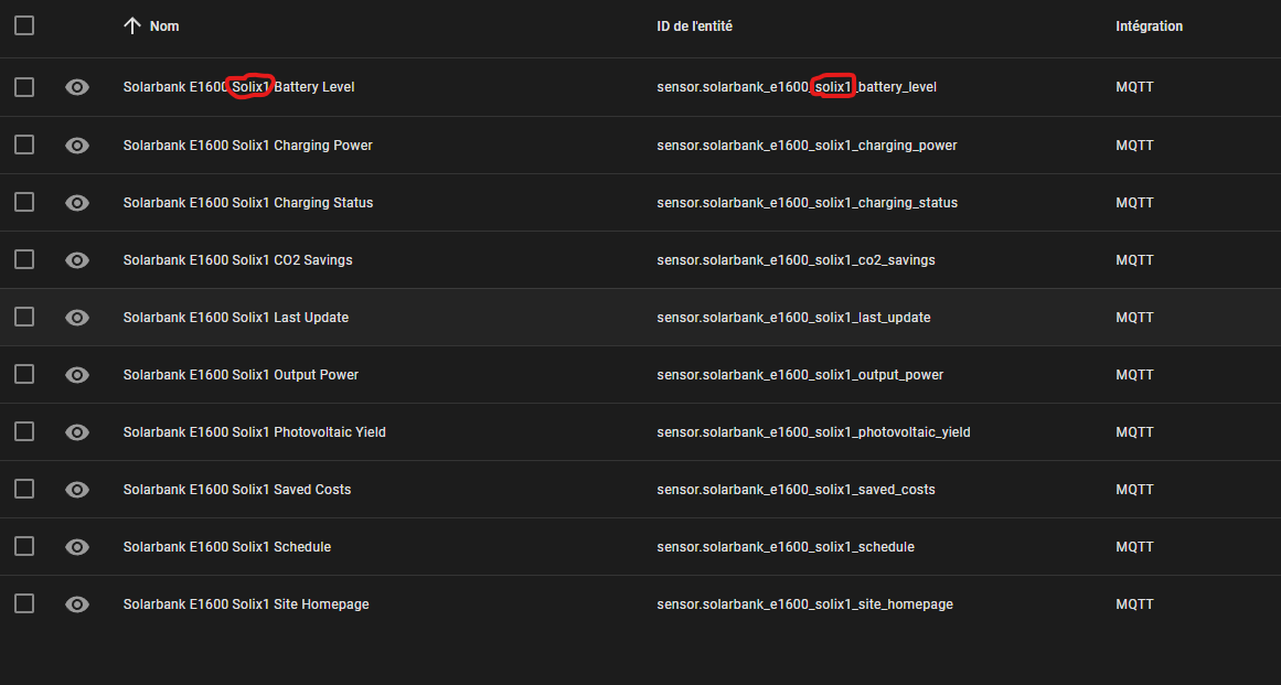

With the v1.6.7 update, now the name and ID correspond to the same battery, but despite the announcement of the sensors for Solix1 and Solix2 in the add-on logs, I only have the sensors from the first Solix1 battery in the entities.
I can’t understand why I have only one battery in the entities while in the logs there are the sensors of the 2 batteries of the 2 sites which are announced

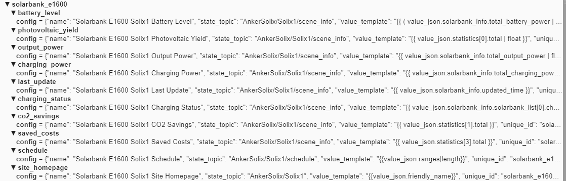

In MQTT Explorer
topic homeassistant/sensor
topic AnkerSolix
