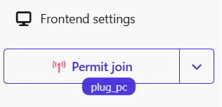

Is there a trick to getting this to work? I just got one of these to try out and it refuses to join. I have Z2MQTT, tons of other devices connect just fine. The link you shared says “Press and hold the reset button on the device for ± 5 seconds (until the blue light starts blinking)”, but mine never starts blinking. It’ll flash a few times, but that’s it. Any idea?
Thanks.
I’m having exact same issue as rmp5s.
They can be a bit tricky to pair - Usually it works if you pair it by a specific router (see picture for example), not “permit join all”. Hold it close to the router.
