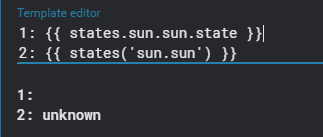

So I have gone through all my configuration and changed things like this:
states.sun.sun.state
To this:
states(‘sun.sun’)
And:
states.sun.sun.attributes.elevation
To this:
state_attr("sun.sun", "elevation")
I did this so that if the state is ‘unknown’ it won’t throw up any errors. But is there a similar way I should use to modify this:
states.light.desk.last_changed
no, last_changed always has to be like that. its not an attributes.
Yeah I had come to that conclusion myself but wondering if I was missing anything.
vs
states(‘sun.sun’)
when the state is unknown and why is it better?
I’ve used a lot of the first type and wondering why you’ve changed.
Thanks
ludeeus
(Ludeeus)
June 23, 2019, 10:12am
11
What the 1: really “say” is AttributeError: NoneType has no attribute state.
