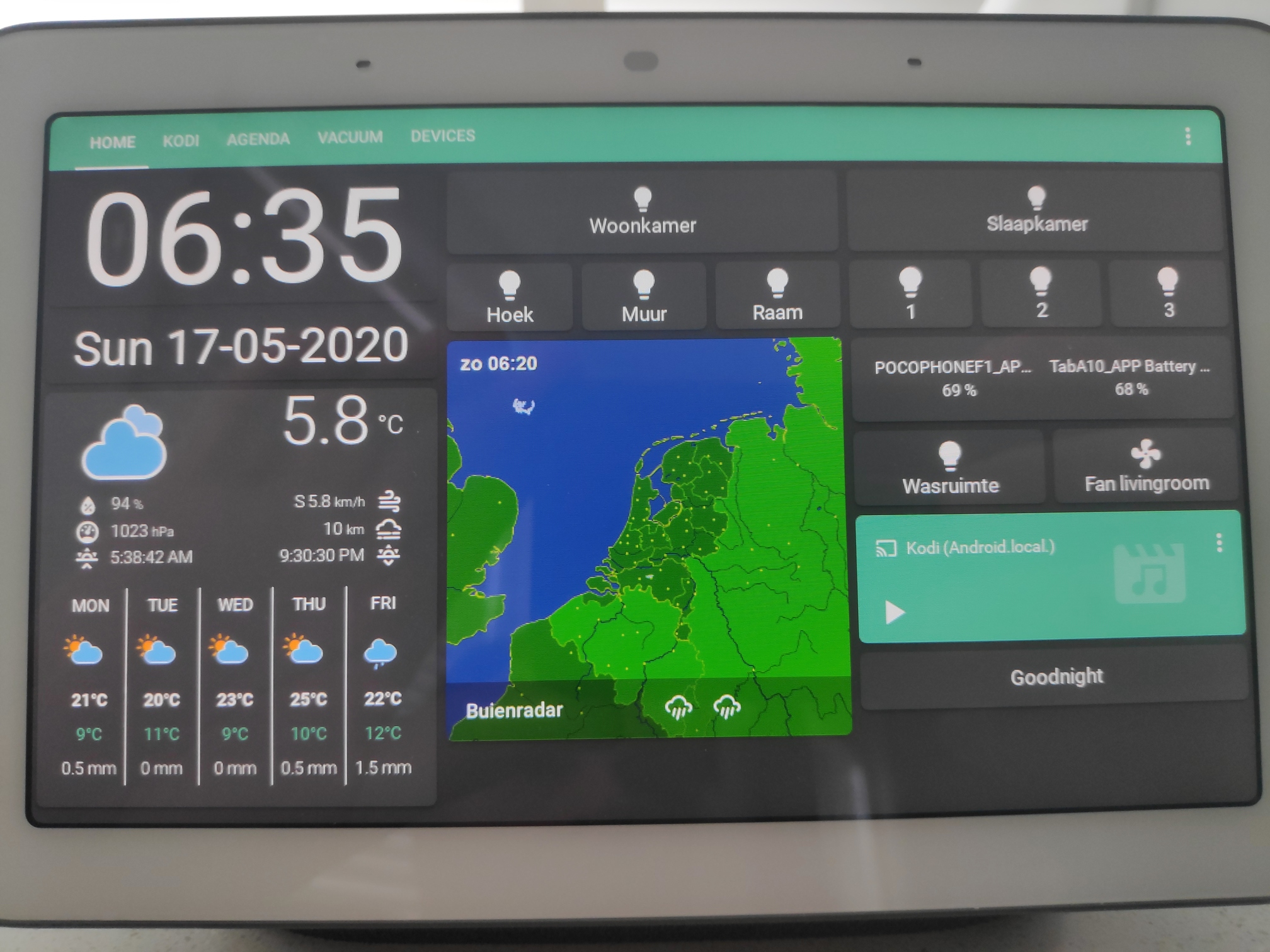

I am quite happy how it turned out. By using https://github.com/maykar/custom-header it also makes it look really nice on the Google Hub. This is my current display.

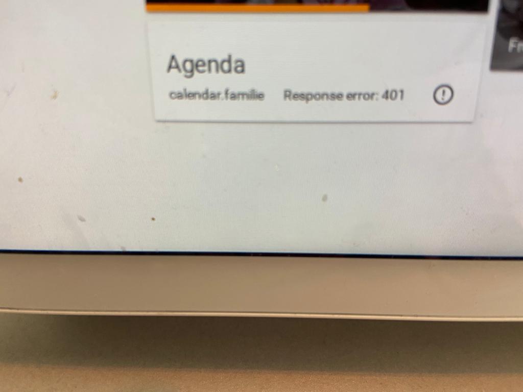

Hi Guys,
I’m using Catt on a google nest hub. I’m also using the calendar Lovelace card. But is won’t load on the hub. it works fine on the app, website of when using the build in cast function of HA.
Anybody any idea??
401 seems to indicate “401: Invalid Credentials” are you sure you are casting the same page as you are looking at on other devices?
I myself am using https://github.com/marksie1988/atomic-calendar-revive to show the calendar on the google hub, perhaps that one works for you also.
I tried that already but when I use atomic my calendar looks strange. Atomic puts all the items in my agenda on all day. I use the iCloud Caldav integration
The strange thing is that It still works when using the build in cast function
