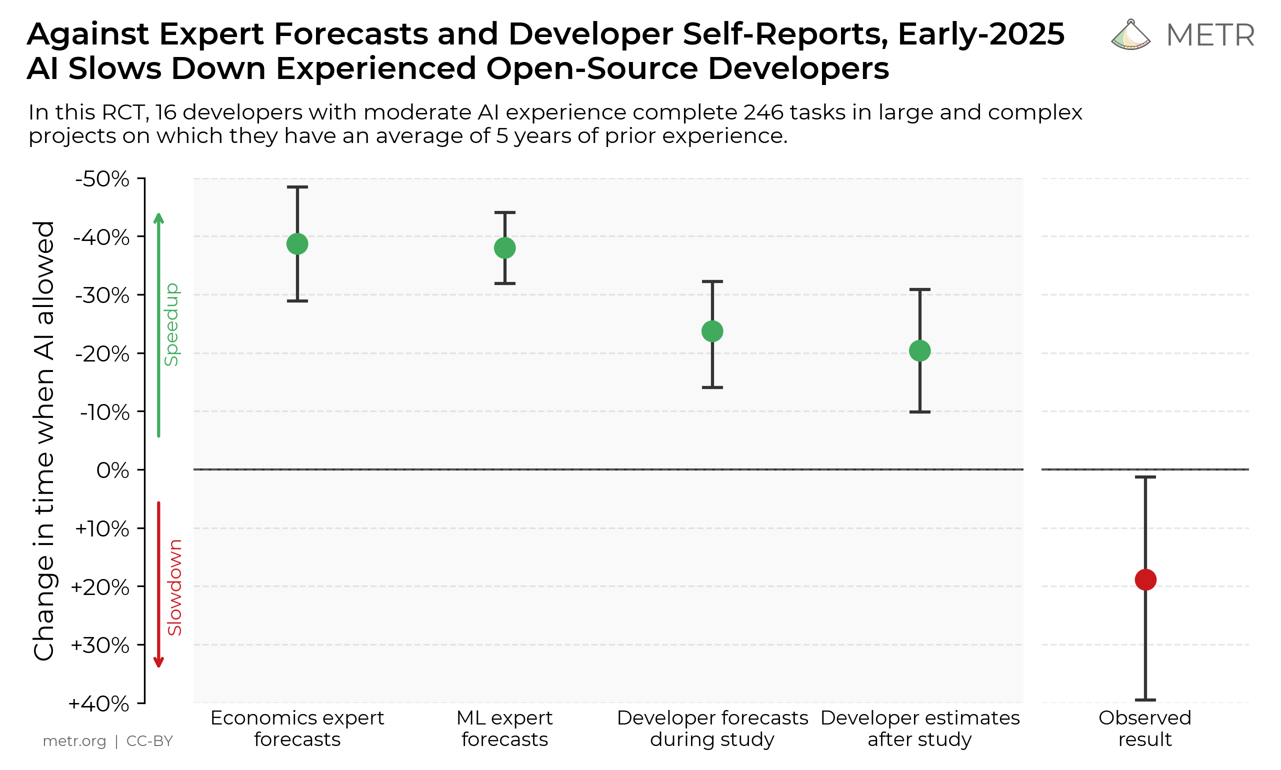

I don’t know about “everyone” but personally I’m attempting to be more efficient by not using LLMs. Measuring the Impact of Early-2025 AI on Experienced Open-Source Developer Productivity - METR

Joke of a study. And completely unrelated.
Got some peer reviewed data to back up your baseless opinion?
How about the fact that:
  • a (probably non-technical) person working on home assistant just trying to get something to work
  • a dev working on their own open source package
Aren’t connected in any meaningful way.
