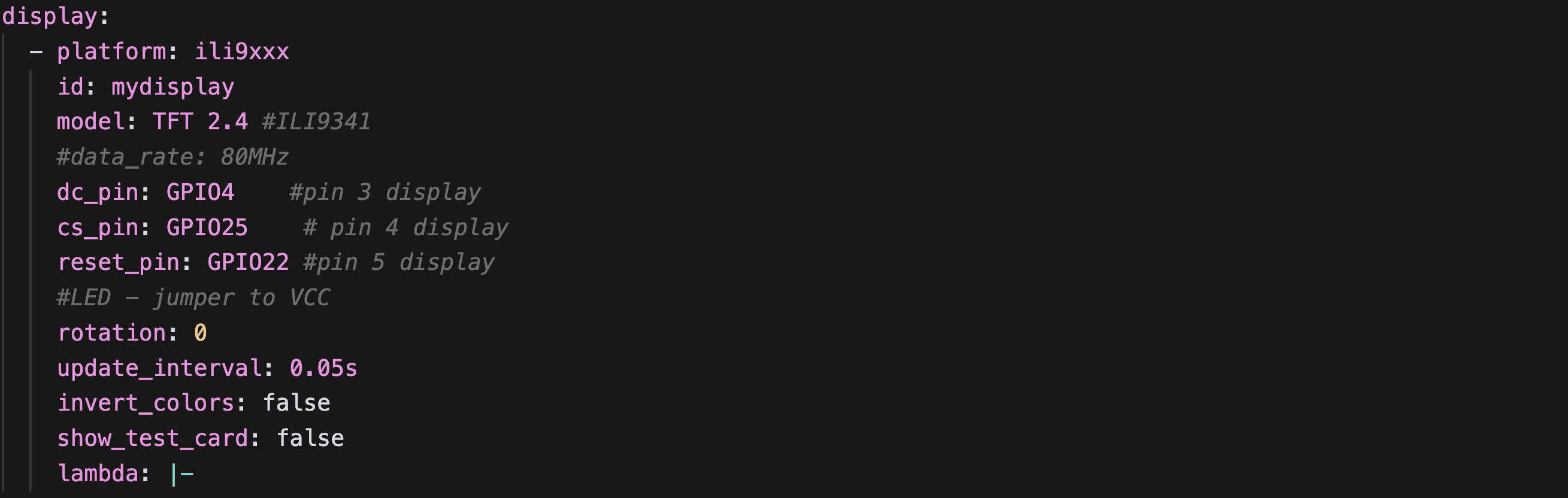

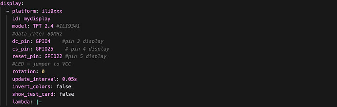

“Create a display using component ili9341 with display type “TFT 4R”. Create animations of each motor. White when off, slow, animated green when on. Start drawing at x=5 and y=5.”
Boom. Code written. Tell it to move groups of objects around. Tedious & complex LVGL display coding just became trivial.

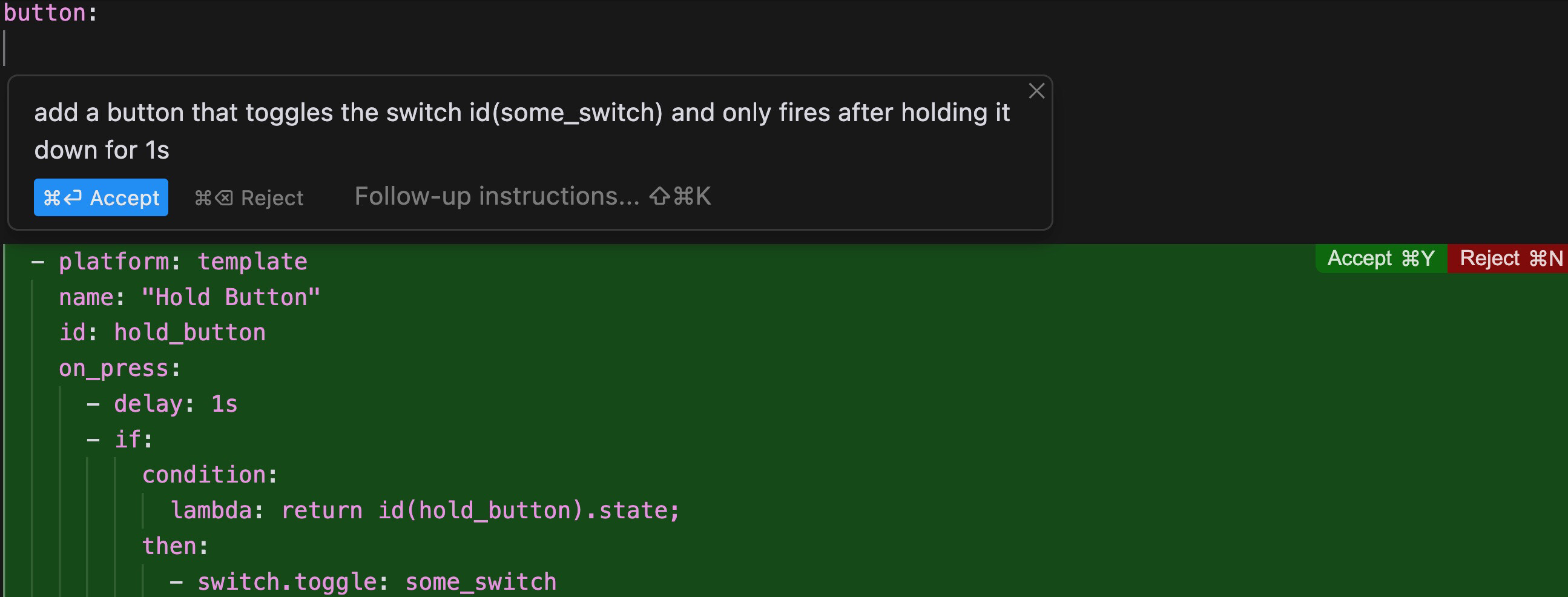

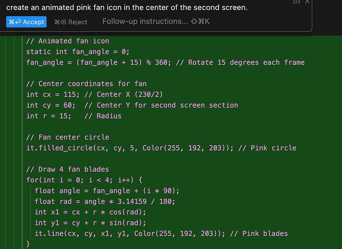

its crazy good at it. I place my cursor in the spot I want, say the button: section, then press option-K (or control-K on linux) and the inline prompt appears type “add a button that toggles the switch id(some_switch) and only fires after holding it down for 1s”

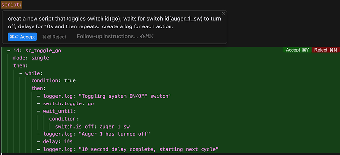

or help w/ scripts
Everything just got very pleasant. Writing complex lambdas are now a breeze.
Or even creating complex new display objects

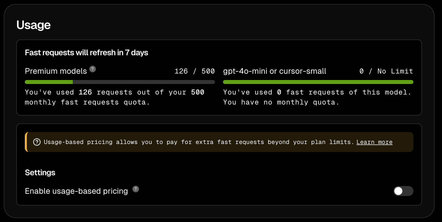

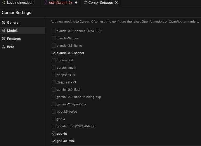

the basic plan gives you 500 requests per month - more than enough for what I do. I just burned up several showing you the above examples

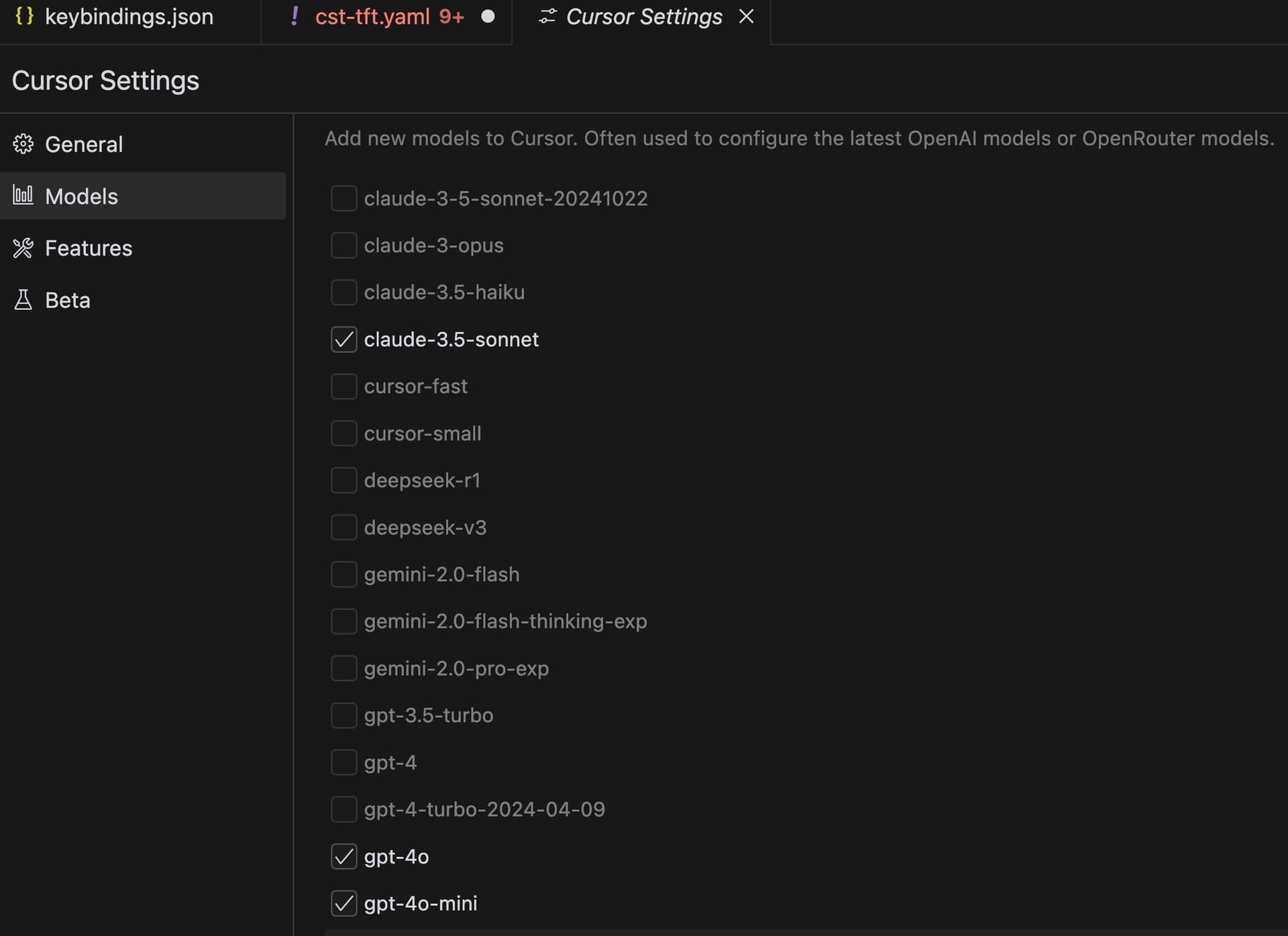

you can en choose which models you want to use. Apparently Claude-3-5-sonnet is the best for things like ESPHome.
