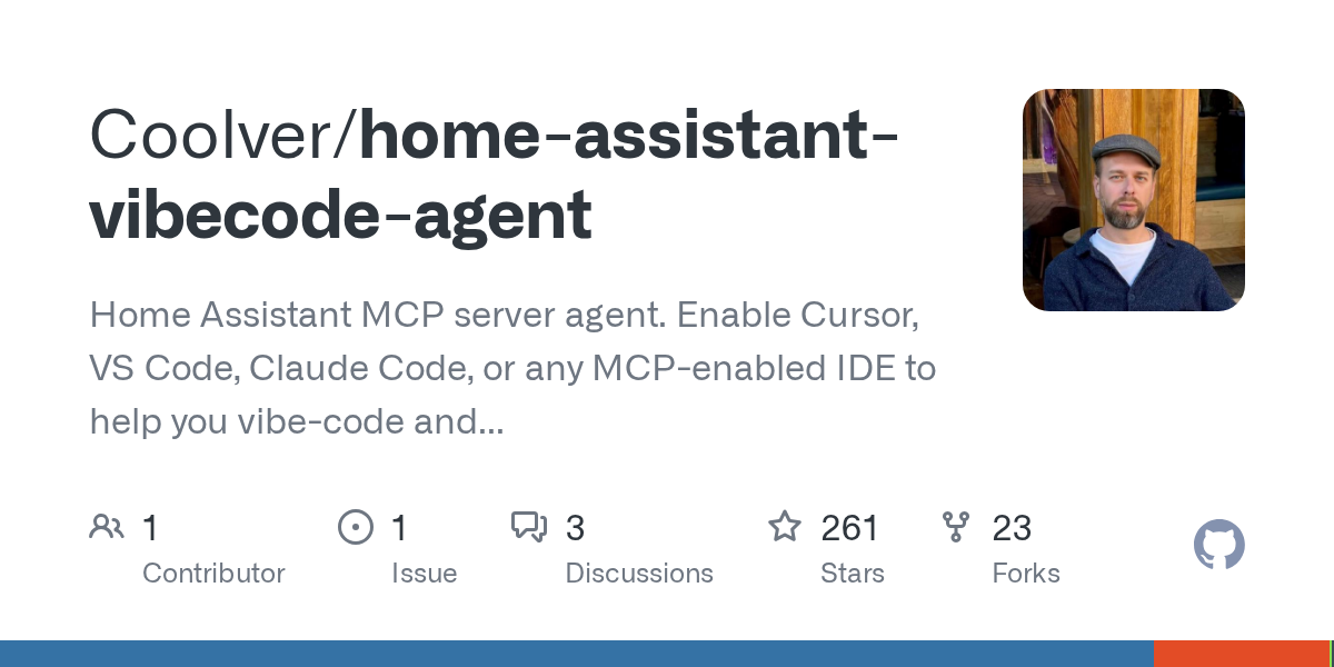

Hey! :wave:
I’ve been working on exactly this kind of setup and ended up building a solution that connects Cursor IDE directly to Home Assistant through the MCP protocol.
It lets you:
  • edit and deploy automations right from Cursor,
  • version all configs and scripts via Git,
  • and communicate with Home Assistant through an on-board Agent (running on your Raspberry Pi).
Basically, it turns your Home Assistant setup into a developer-friendly workflow — you can treat it like any other codebase: branch → edit → commit → deploy, all without SSH or manual YAML uploads.
I wrote a detailed story and released the full source code here:
:point_right: Cursor agent for Home Assistant | How I built a multi-zone heating controller and a Home Assistant Agent + MCP for Cursor.
Would love to hear your thoughts if you try it out!

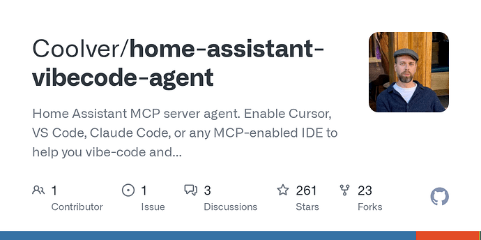

GitHub link update after repository rename:
this is amazing! I am grateful! Thank you for this!
