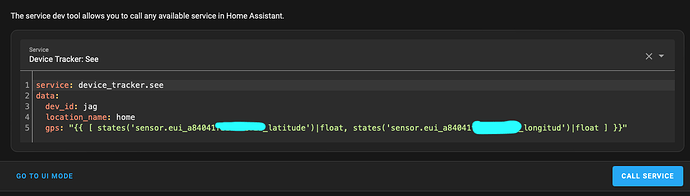

I’m struggling to understand how the device tracker updates. I went into developer tools, and called the service:
I associated it with the user called jag (yes we drive the most boring car in the world!)
Does this device tracker now update itself? Or do I have to do something else? I’m stuck at home for a few days, so no chance to test it!
Apologies for the noob questions.
You will have to add an automation that pushes the info to the device_tracker every time the device sends you an update.
The code you have for the action should be OK, the automation should trigger when the sensor state changes.
Just one thing to add to @Sir_Goodenough’s post… When you create your automation, you likely want to remove the location_name variable since not every set of coordinates will be home.
