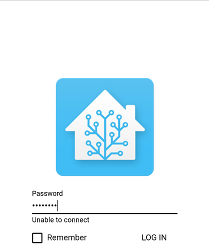

Thanks. I am seeing the front end, just won’t let me login and nothing is added to the ip_ban.yaml.
so when you see the frontend, you enter the API and nothing happens?
Is it HTTPS? that might be the problem if there’s no ssl on the Pi?
ah you removed ssl and the base url?
The reverse proxy is routing a HTTPS request to a HTTP request so the Pi3 is seeing a request on http://pi3ipaddress:8123. There is no certificate on-board the Pi and the ha config has not been told that either.
So I get this remotely:
Then this:
You will need to fix the reverse proxy config.

Hi xbmcnut, I don’t know if you are still interested, but i’ve recently came across a solution to your problem. You need to add a websocket in the “custom heathers” section, just when you are creating the entry for the reverse proxy. Take a look to this link.
https://www.home-assistant.io/docs/ecosystem/synology/
Hope it helps!
