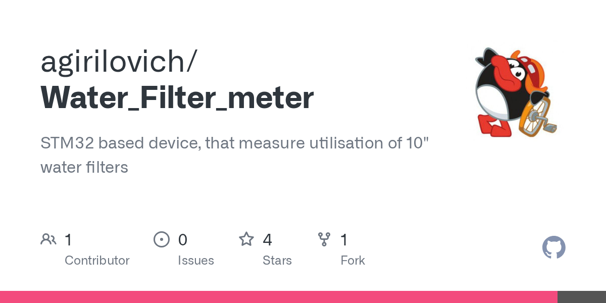

I found the following GitHub project for this sensor with STM32
