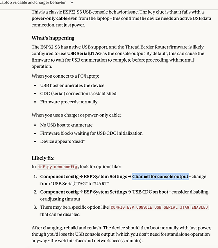

Huh, that sounds really weird. Don’t want to be that guy, but Claude thinks it could be this:
Can you try?

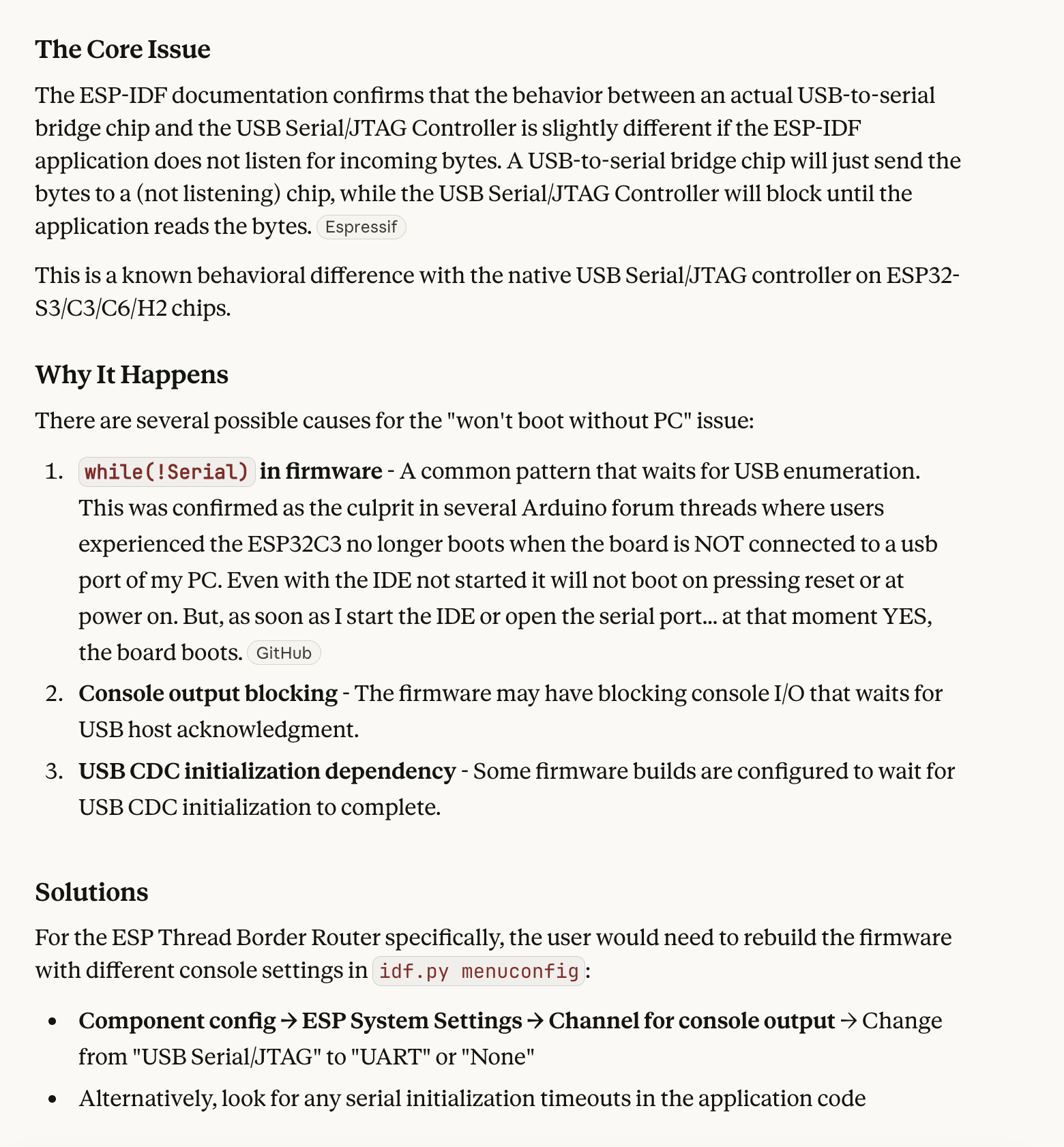

Can you try?
This worked, thanks @kotrfa! I switched Component config > ESP System Settings > Channel for console output from USB Serial/JTAG serial to Default: UART0. That other option mentioned doesn’t exist.
Rebuilt, reflashed and now it works standalone. Obviously, I no longer get logs if I connect to a computer, but if I ever need that - I can flash back to the previous image.
