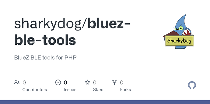

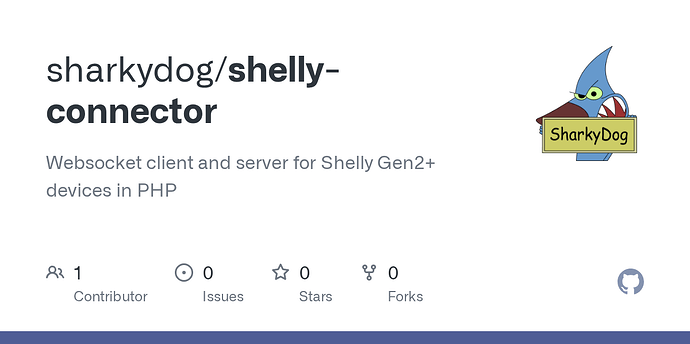

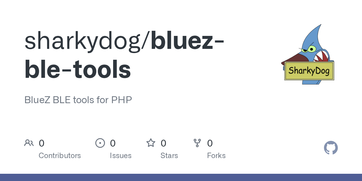

I recently made a RPi Zero 2W pose as a Shelly device and act as ble proxy for scanning,
The project is in PHP glued together from previous work published in GitHub and some parts not yet published.
Runs as cli script, uses hcitool, hciconfig, hcidump and can be started as a systemd service.
If somebody is interested, I can publish the thing as an example, otherwise I might not bother :slight_smile:
The two main pieces are:
and
The part that still exists only on my dev server is a virtual shelly device which will be pushed to shelly-connector in few days.
