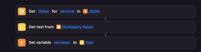

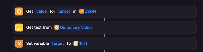

  1. Now add the following objects to get the JSON:
  1. Now we will get the service and save it in a variable:
  1. Now we will get the entity_id from the JSON:
  1. Now we will get the target from the JSON:
