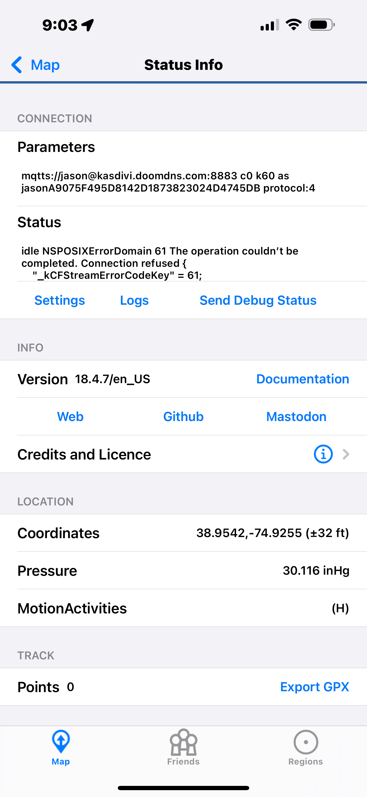

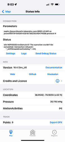

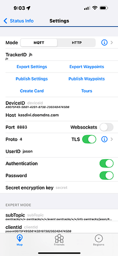

I am running HA using HA OS I used to have Owntrack using HiveMQTT running with my apple iphione. I am trying to get it running again. In the various documentatatio for the IOS app. I find a lot of various approaches to the correct username and password. I have tried a HiveMQTT
credential and also my HA Both gives me the same error Can anyone help Images of Confiiguration and Error message attached
The problem turned out to be a leading space on the broker address. and also on the encryption key (which was impossible to see with the # mask) now to try to get the map to word
