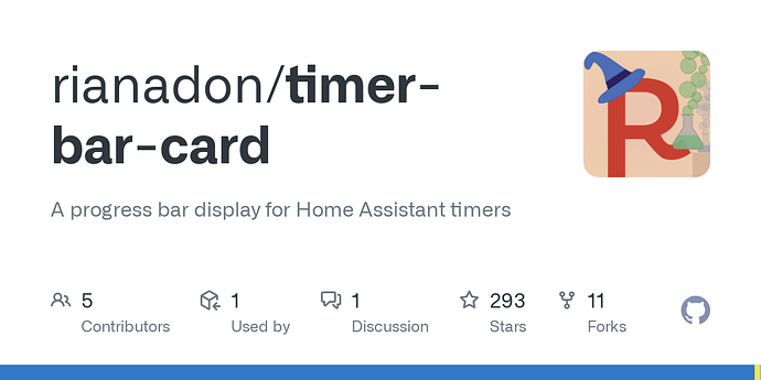

I use this addon to visually see the timer countdown.
