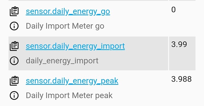

Your Utility meter uses
as a source.
All utility meter does is allow you to have an odometer of how much energy was used when the state of the utility meter was set to that tariff at that time.

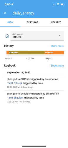

Here is my timeline for my utility meter
Maybe check yours to see if your automations are working correctly
You can actually see the graph for each tariff to verify its working as well.
