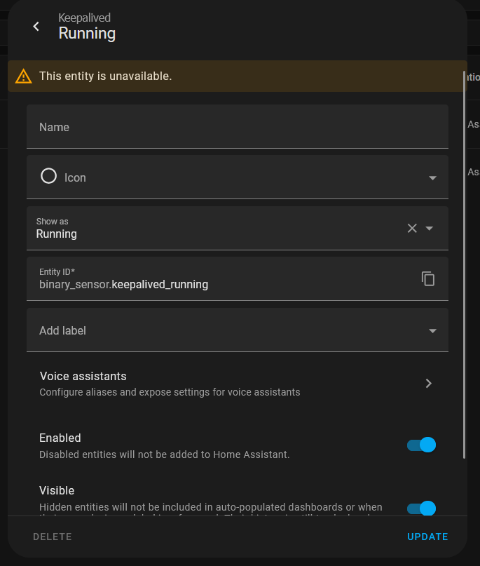

Sorry, I have a stupid question. :man_facepalming:t3:
I’ve enabled binary_sensor.keepalived_running but it only shows that the entity is unavailable. I’ve tried restarting the add-on and even restarted HA with no change. :confused: Any ideas how to resolve this so the automation will fire?
