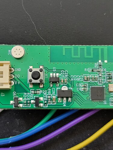

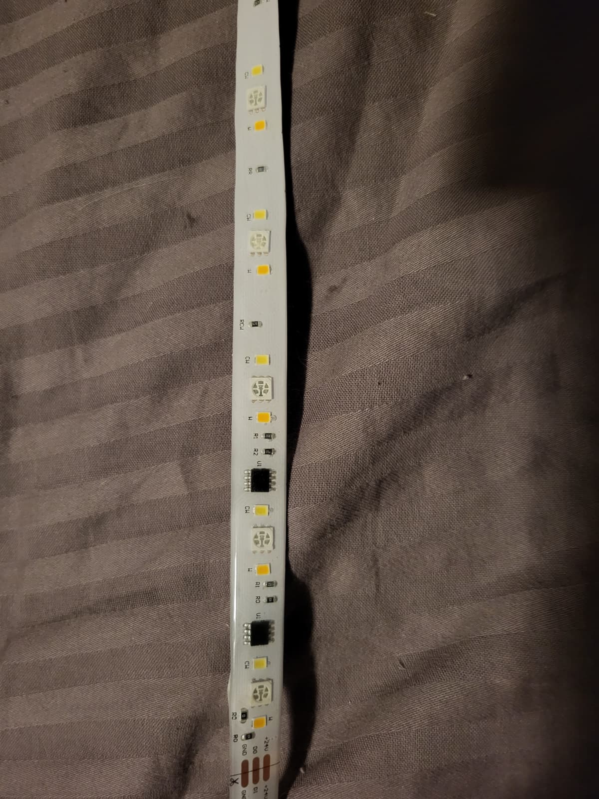

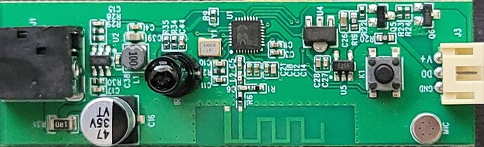

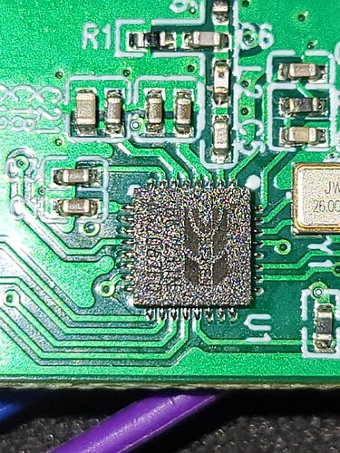

you think its possible to write a little script that runs on the device that converts the blue and red channels that are used for the white/warmwhite leds, to a white-tint slider so its can be used in home assistant?
EDIT:
I removed pin 8 alltogether and enabled it to high at boot. Now switching from color to white rapidly on the remote doesnt make it freak out and toggling pin8 on/off. Remote is more fluent now.
2
added light turn off also for white leds for button 3 because they stayed on when pressed.
Now ill try brightness buttons 1 and 2 to increase brightness for color and white, freeing the arrow buttons on the remote.
