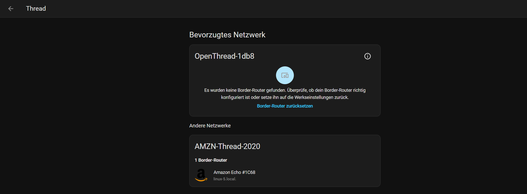

screenshot for thread network:
i have the same problem, did you find a solution ?
@rbfr How did you manage to make the border router your preferred network? I tried what you did and I think it works to a certain point but I can’t get the router as preferred network so I can’t add any devices :frowning:

I think I solved it by doing the following:
  • run the otbr docker
  • run the homeassistant docker
  • enable the otbr integration
  • enable the thread integration (which should not see the network and allow you to make this preferred)
  • enable matter (which now allows you to add matter devices)

And I cannot get it run as it is never recognized as Border Router.
