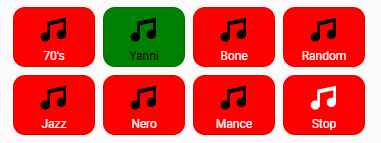

In my system, I created a button group as below. Each button activates an automation that sends the command to Alexa and cycles the buttons.
Here is the code for Yanni.

Here are the different things each button does.
media_content_id: "\"Play 70s on iheartradio\""
media_content_id: "\"Ask my media to play yanni\""
media_content_id: "\"Play music by down to the bone\""
media_content_id: "\"Play some music\""
media_content_id: "\"Play smooth jazz on iheartradio\""
media_content_id: "\"Ask my media to play peter nero\""
media_content_id: "\"Play music by Junior Mance\""
action: media_player.media_stop
