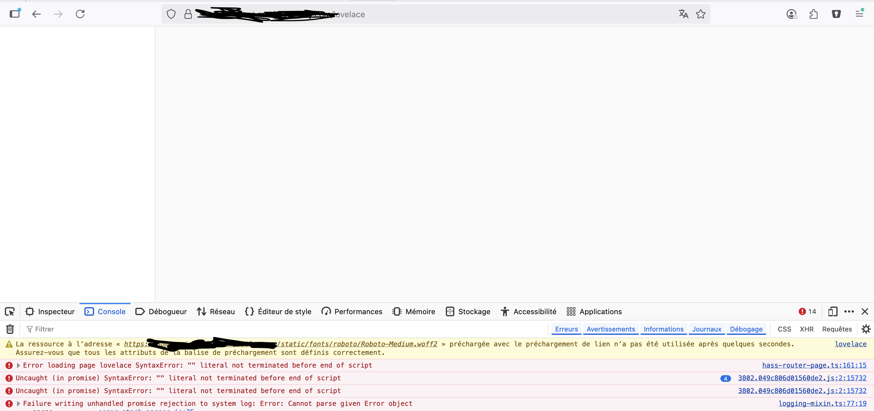

Thank you for all your messages but I have a weird issue with a Home Assistant behind NPM , installed on a VPS and accessing to my local server via VPM, which was working for years. Also, I have 9 others websites working well behing this NPM and accessing via VPN as well.
Here are my NPM config tabs :
  • Block Common Exploit is checked (also tried with unchecked and didn’t change anything)
  • WebSocket Supports checked
For SSL :
  • Force SSL is check, everthing else is unchecked
And Advanced Tab contains :
proxy_set_header Host $host;
proxy_set_header X-Real-IP $remote_addr;
proxy_set_header X-Forwarded-For $proxy_add_x_forwarded_for;
proxy_set_header X-Forwarded-Proto $scheme;
proxy_set_header Upgrade $http_upgrade;
proxy_set_header Connection "upgrade";
My Custom Locations tab is empty.
For the configuration.yaml I have my IPs as well under http section like this :
homeassistant:
  external_url: "https://ha.test.com"
scene: !include scenes.yaml
http:
  use_x_forwarded_for: true
  trusted_proxies:
    -  myVPN subnet mask
  cors_allowed_origins:
    - https://ha.test.com
If I delete my subnet mask I have an error 400, so I think configuration.yaml is well configured.
Everything should be great except that I see an almost empty page when going to ha.test.com whereas it’s working great via my Local IP. Here what I see :
Am I the only one with this weird behaviour ?
