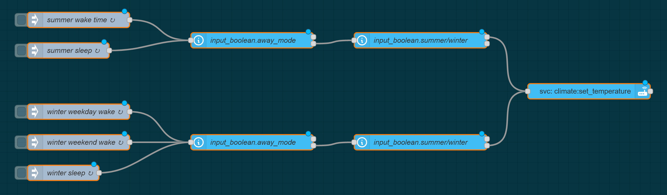

I’m not familiar with the light schedule and since you didn’t post the flow don’t know how many different periods they trigger.
It seems there are 5 change points in total. I used simple inject nodes for each time change. Away mode would not make any changes to the thermostat. A summer/winter input boolean would switch between seasons.
[{"id":"22d27353.d53374","type":"inject","z":"35b293a2.b5aafc","name":"summer wake time","props":[{"p":"payload"},{"p":"topic","vt":"str"}],"repeat":"","crontab":"00 08 * * *","once":false,"onceDelay":0.1,"topic":"","payload":"65","payloadType":"num","x":320,"y":880,"wires":[["84ecd731.06118"]]},{"id":"ed72346c.86a3d","type":"inject","z":"35b293a2.b5aafc","name":"summer sleep","props":[{"p":"payload"},{"p":"topic","vt":"str"}],"repeat":"","crontab":"00 23 * * *","once":false,"onceDelay":0.1,"topic":"","payload":"70","payloadType":"num","x":300,"y":940,"wires":[["84ecd731.06118"]]},{"id":"20ece2f1.468196","type":"inject","z":"35b293a2.b5aafc","name":"winter weekday wake","props":[{"p":"payload"},{"p":"topic","vt":"str"}],"repeat":"","crontab":"00 07 * * 1,2,3,4,5","once":false,"onceDelay":0.1,"topic":"","payload":"72","payloadType":"num","x":320,"y":1060,"wires":[["fbed2e10.fbf658"]]},{"id":"3b4706c9.0176a2","type":"inject","z":"35b293a2.b5aafc","name":"winter weekend wake","props":[{"p":"payload"},{"p":"topic","vt":"str"}],"repeat":"","crontab":"00 08 * * 6,0","once":false,"onceDelay":0.1,"topic":"","payload":"72","payloadType":"num","x":320,"y":1120,"wires":[["fbed2e10.fbf658"]]},{"id":"97ffd70b.c1f31","type":"inject","z":"35b293a2.b5aafc","name":"winter sleep","props":[{"p":"payload"},{"p":"topic","vt":"str"}],"repeat":"","crontab":"00 23 * * *","once":false,"onceDelay":0.1,"topic":"","payload":"75","payloadType":"num","x":290,"y":1180,"wires":[["fbed2e10.fbf658"]]},{"id":"84ecd731.06118","type":"api-current-state","z":"35b293a2.b5aafc","name":"input_boolean.away_mode","server":"6b1110b5.183a4","version":2,"outputs":2,"halt_if":"on","halt_if_type":"str","halt_if_compare":"is","entity_id":"","state_type":"str","blockInputOverrides":false,"outputProperties":[{"property":"payload","propertyType":"msg","value":"","valueType":"entityState"},{"property":"data","propertyType":"msg","value":"","valueType":"entity"}],"override_topic":false,"state_location":"payload","override_payload":"msg","entity_location":"data","override_data":"msg","x":660,"y":920,"wires":[[],["dacb08ed.ca4bb"]]},{"id":"fbed2e10.fbf658","type":"api-current-state","z":"35b293a2.b5aafc","name":"input_boolean.away_mode","server":"6b1110b5.183a4","version":2,"outputs":2,"halt_if":"on","halt_if_type":"str","halt_if_compare":"is","entity_id":"","state_type":"str","blockInputOverrides":false,"outputProperties":[{"property":"payload","propertyType":"msg","value":"","valueType":"entityState"},{"property":"data","propertyType":"msg","value":"","valueType":"entity"}],"override_topic":false,"state_location":"payload","override_payload":"msg","entity_location":"data","override_data":"msg","x":660,"y":1120,"wires":[[],["cfbcc974.41521"]]},{"id":"dacb08ed.ca4bb","type":"api-current-state","z":"35b293a2.b5aafc","name":"input_boolean.summer/winter","server":"6b1110b5.183a4","version":2,"outputs":2,"halt_if":"on","halt_if_type":"str","halt_if_compare":"is","entity_id":"","state_type":"str","blockInputOverrides":false,"outputProperties":[{"property":"payload","propertyType":"msg","value":"","valueType":"entityState"},{"property":"data","propertyType":"msg","value":"","valueType":"entity"}],"override_topic":false,"state_location":"payload","override_payload":"msg","entity_location":"data","override_data":"msg","x":990,"y":920,"wires":[["c99a43d.259064"],[]]},{"id":"cfbcc974.41521","type":"api-current-state","z":"35b293a2.b5aafc","name":"input_boolean.summer/winter","server":"6b1110b5.183a4","version":2,"outputs":2,"halt_if":"on","halt_if_type":"str","halt_if_compare":"is","entity_id":"","state_type":"str","blockInputOverrides":false,"outputProperties":[{"property":"payload","propertyType":"msg","value":"","valueType":"entityState"},{"property":"data","propertyType":"msg","value":"","valueType":"entity"}],"override_topic":false,"state_location":"payload","override_payload":"msg","entity_location":"data","override_data":"msg","x":990,"y":1120,"wires":[[],["c99a43d.259064"]]},{"id":"c99a43d.259064","type":"api-call-service","z":"35b293a2.b5aafc","name":"","server":"6b1110b5.183a4","version":3,"debugenabled":false,"service_domain":"climate","service":"set_temperature","entityId":"climate.living_room","data":"{\"temperature\":\"{{ payload }}\"}","dataType":"json","mergecontext":"","mustacheAltTags":false,"outputProperties":[],"queue":"none","x":1320,"y":1020,"wires":[[]]},{"id":"6b1110b5.183a4","type":"server","name":"Home Assistant","version":1,"legacy":false,"addon":true,"rejectUnauthorizedCerts":true,"ha_boolean":"y|yes|true|on|home|open","connectionDelay":true,"cacheJson":true}]
Oh man, that was so easy. I feel like such a boob.
Thank you sooooo much!!!
Just FYI, I use a high_temp/low_temp situation in heat_cool mode. I just added two msgs to the injector node and changed the expression in the set_temperature node.
Amazing!!
