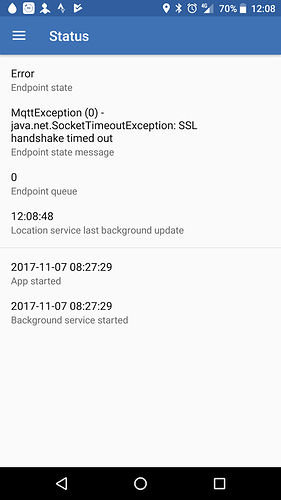

When I go to “status” in owntracks, I see this error:
so clearly, something, somewhere is going wrong, but I can’t figure out where I’m going wrong. Any ideas?
