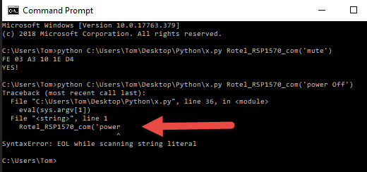

So got my test script working when I use a function argument without space
But with space it throws an error. And I think it is the command line syntax.
How do I format the function argument with a space?
I want to use a space because I want to pick the argument in my script and make it an attribute in a HA-sensor.

Can you use Power_Off or something and then replace the _ with a space in HA or in the python script?
After a lot off copy-and-paste research, all it took was double quotes for the function and argument.:smiley:
python C:\Users\Tom\Desktop\Python\x.py "Rotel_RSP1570_com('power Off')"
