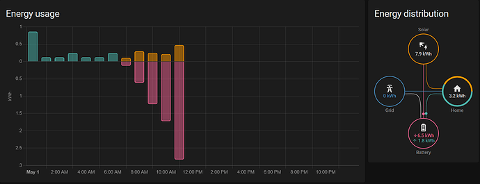

They should all show up in the drop downs for the energy dashboard now. Make sure you add the generator as if it was a flow in from the grid, otherwise you won’t see all the pretty graphs!
Example pic from today:
