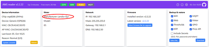

@flo2141 The Landis+Gyr appears automatically when the Slimmelezer is connected, it is very curious. No consumption seen by the Slimmelezer (although there is a correct 60W charge 1.7.0).
@GSzabados Using AMS firmware v2.2.22
