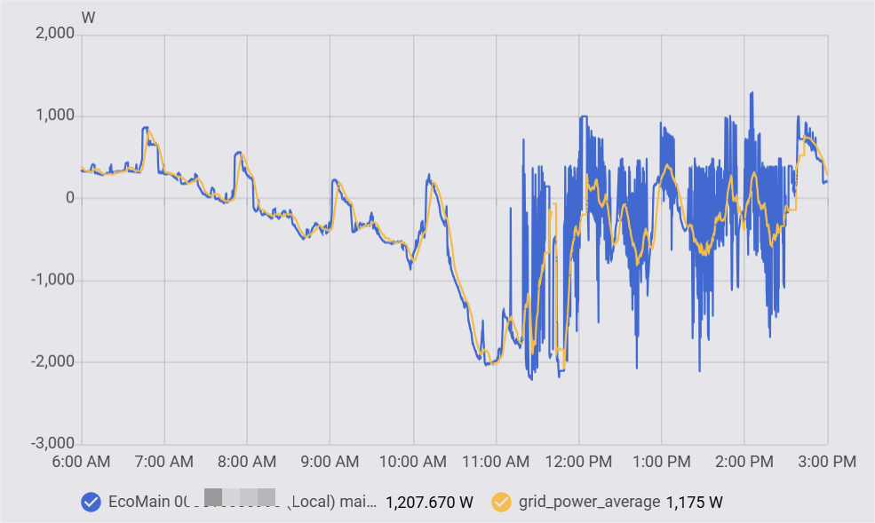

5. Why I Used Averaged Grid Power Instead of PV Power
At first I considered using PV generation directly as the trigger. But solar production alone doesn’t tell you whether there is actually enough surplus power available for another load.
For example, my array might be producing 5 kW, while the house is already using 5.5 kW. In that situation, I’m still importing power from the grid. On the other hand, 2 kW of solar generation can be more than enough when the house is only using 1 kW.
Grid Power gives a much better picture of the actual balance between generation and household consumption. A negative value means the house is exporting power, while a positive value means it is importing from the grid.
The problem with using the raw Grid Power value is that it can change quite quickly as appliances switch on and off. To make the automation less sensitive to short fluctuations, I created a 5-minute average Grid Power sensor and use that as the trigger for the Blueprint.
This gives the automation a smoother signal to work with, while still reflecting the actual balance between the house and the grid.
raw vs averaged Grid Power comparison

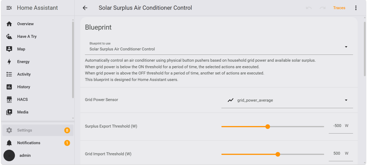

6. My Current Configuration
Here’s what I’m actually running right now. It’s been working reliably for me. These are just the values that happened to work well in my setup, not recommended defaults.
The delay settings are mainly there to accommodate physical button pushers. Depending on the device, you may need longer or shorter delays for reliable operation.
Setting My Value
Trigger Sensor 5-Minute Average Grid Power
Surplus Export Threshold -500 W
Grid Import Threshold 500 W
Stability Time 60 seconds
Delay after Power Button 5 seconds
Delay between Temperature Presses 8 seconds
With these settings:
  • When Grid Power stays below -500 W for 60+ seconds → press power button, then press temp-down 3 times.
  • When Grid Power stays above 500 W for 60+ seconds → press power button, then press temp-up 3 times.
配置截图
These work well for my system, but yours will probably be different depending on your PV size and household demand. I’d suggest starting conservative and adjusting from there.
