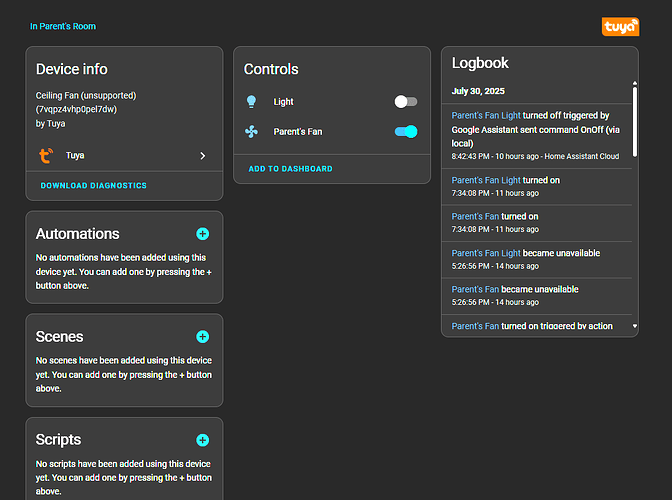

I was able to get my same fan linked with my setup using the native Tuya integration by just searching for it in devices and services. I didn’t need to use HACS for this.
Just letting you know in case that’s an easier way for you to mess with it. Not that what you’ve built isn’t impressive! Looks like you learned a lot through that process.
The main reason I went the hard route was because I wanted to avoid as many cloud bases services as possible. However, it is good to know this route is an option. Maybe I will try it to see how it is supposed to respond to inputs and use that to tweak the fully local integration.
