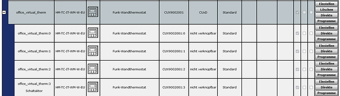

I have now created a virtual device with CUxD, following a Youtube video from “verdrahtet” where the author of the video tries to do something very similar, but with IOBROKER instead of HA.
The device is showing up in RaspberryMatic but I cannot find it in HA.
Any idea why not?

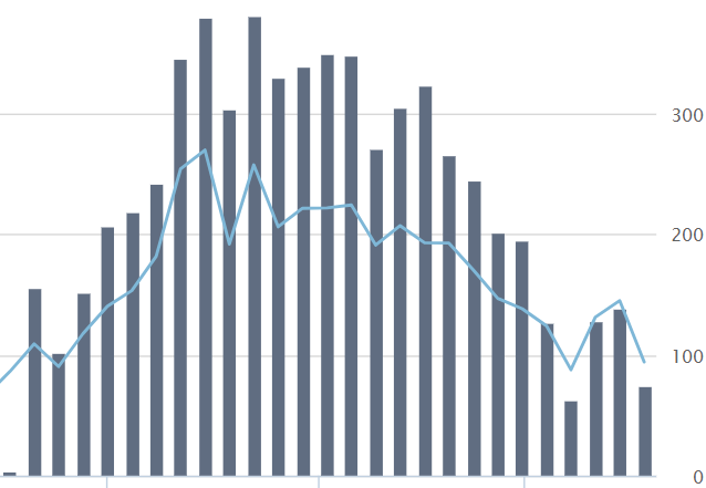

But the sensors on the radiators send their data to a cloud where I can compare it with my neighbours data.
Mind you that in this house there are 8 apartments of the largest size (which is what we have). The majority of apartments are either half or one third the size of our.
The bars is our usage, and the line is the average in the house.
It’s quite clear when our TRV’s was installed?
Why is there the cloud functionality? Is it for the central heating to adjust to the demand?
Not sure if it does that. I doubt it.
It’s not a real time system as far as I know. Right now the latest data I can access is three days old.
The reason is that we pay for the usage.
The sensors are (as far as I understand it) cumulative temperature sensors mounted on the radiators, so each time I let hot water in to the radiator it starts ticking up.
During the real winter the radiators will be on most of the time I assume (given how we had the manual radiators valves set before) so that won’t change much.
What will change is that when we leave home all will be off, and when we get sunlight to heat up a room that room will turn off.
