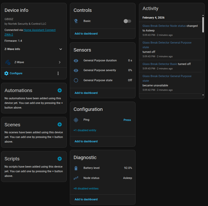

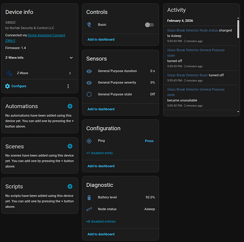

I have just included this sensor into Home Assistant and the entities are all wrong:
It seems that it is being detected as a light? The sensor is always in sleep mode. The documentation says that pressing the button 3 times will wake it up for 5 minutes however when I press it three times the battery level gets updated and the node goes back to sleep instantly. I’ve tried playing glass break sounds right next to it and nothing happens. I’ve exlcuded, reset and re-included three times and that’s made no difference.
