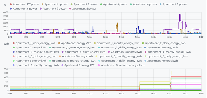

I am using utility meter for recording monthly and daily energy consumption. I have several meters for several apartments as well. The value comes from a pzem004-t. It usually works fine, but sometimes, I get a huge spike in the utility meter (please the pzem-004t doesn’t show any spike, so I am quite sure the problem lies in utility meter).
Please see a screenshot below, there is one big spike in utility meter at 16:17 (from 250kwh to 409 kwh), and another one at 20:12(from 409kwh to 800kwh). And it happened to all of the utility meters:
Anyone experienced the same issue, and found any solution?
