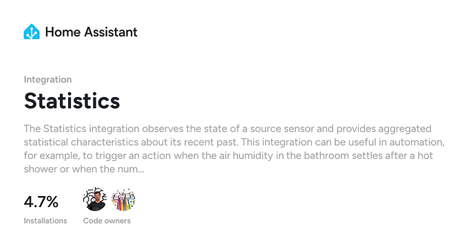

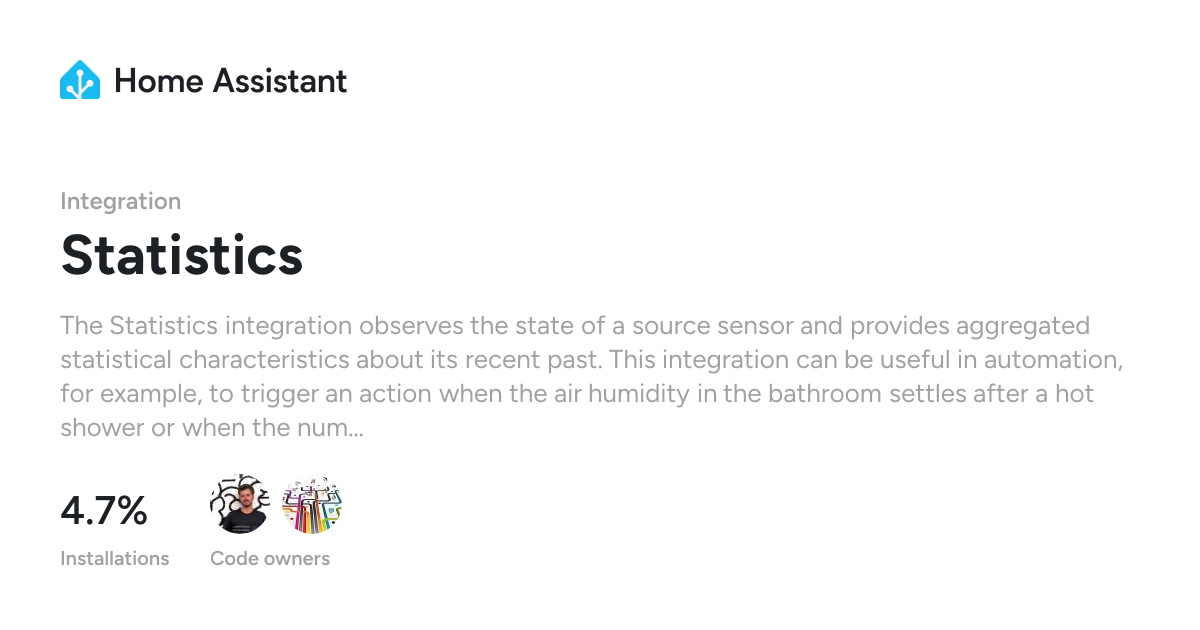

For my tank I use statistics for delta
And then if you only want only negative numbers perhaps a template on the statistics entity.
