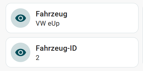

here are the options I do have available in the selection from the Charging station:
as well as sensor value available (name and via an ID)
