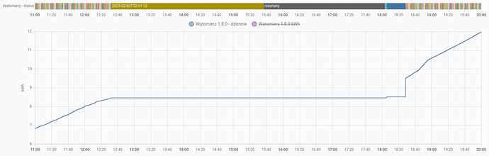

Yesterday I noticed strange behavior. For some time my sensor was offline (12:30 - 18:30):
And daily calculation for that sensor “stopped” - so it was calculated wrong:
All on one chart:
Total usage at 12:31:34 is 1530.87 kWh and at 18:28:26 is 1538.49. So delta is 7.62 kWh.
And for daily usage at 12:31:34 is 8.46 and at 18:28:26 is 9.52. So delta is 1.06.
But, hourly (and also daily) usage from Energy dashboard is OK. As you can see below at 18 o’clock “missing” usage is present:
Why my manually defined utility_meter is not calculated correctly?

From charts I have values:
total usage at 12:31:34 is 1530.87 kWh and at 18:28:26 is 1538.49. So delta is 7.62 kWh.
daily usage at 12:31:34 is 8.46 and at 18:28:26 is 9.52. So delta is 1.06 .
As You can see 6.56 is missing in daily utility_meter, but energy dashboard is OK.
