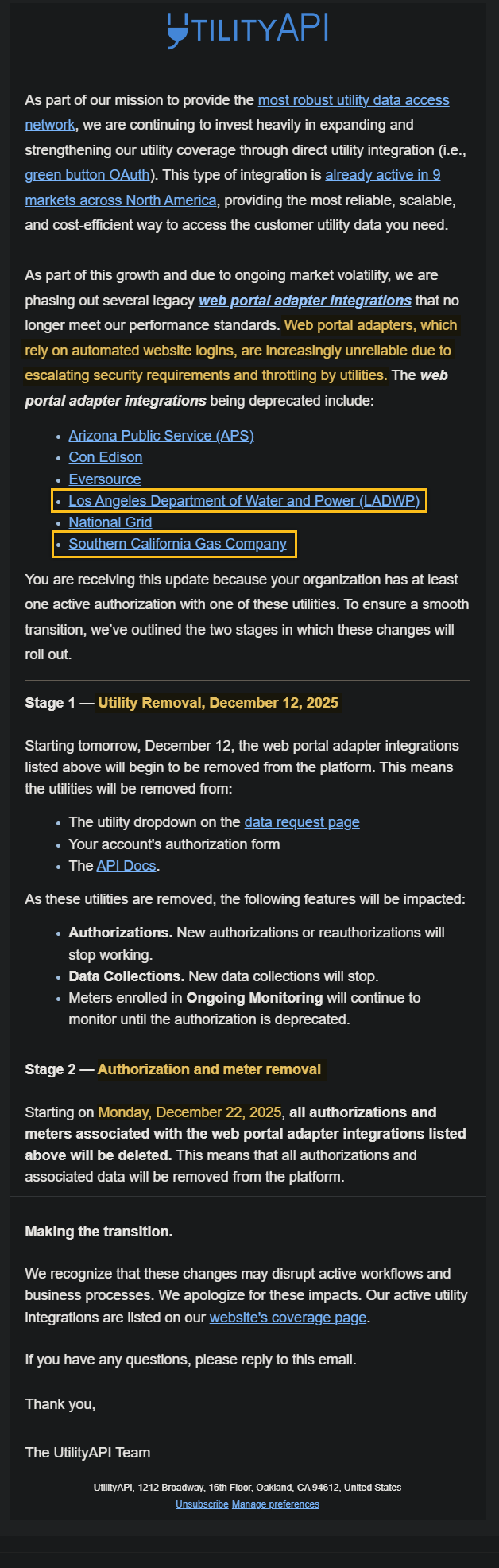

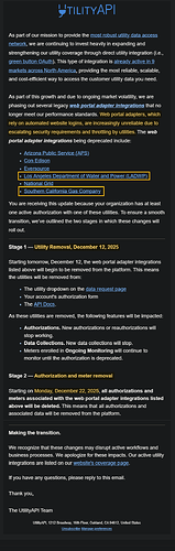

Just got an email today that UtilityAPI is shutting down connections for LADWP and Socal Gas.
